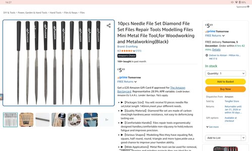

thanks for replying but pardon my ignorance what do you mean by Swiss filing a draining break on the extrusion's ridge at each side? regards
Filing a little rounded "gutter" through the ridge so the water dammed by the ridge can flow away.
Using, as an example the "half round" centre file of these jeweller's needle files LINK.
Quality ones were known as "Swiss files" where I did my practical training. They are ultra fine cut so will give a nice clean finish to making the required draining gutter across the ridge.
Reactions: breeze1470
12,554
4,708
Swiss files aka needle files, very small files with different shapes.
