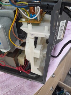

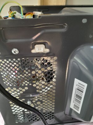

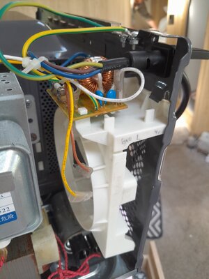

Hi Sam I am chief engineer electrical. You were bang on the cooling fan is kaput. Coil to the motor broken. Taken the fan and coil out.
