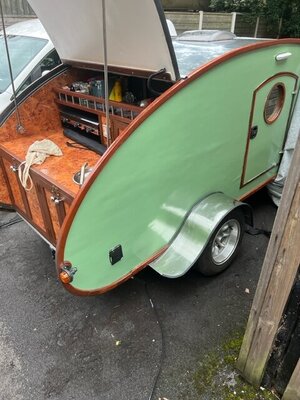

The issue is (presumably) ingress into the plywood walls of the caravan. This appears to be occurring in the exposed gap where the kitchen roof hinge shuts, and is travelling through the ply into the living area of van itself. The images below show the problem well:
1) Kitchen roof open showing the RHS seal where the roof meets the sidewall.

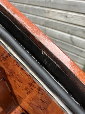

2) Close-up of the roof seal. To the right of the rubber seal is exposed plywood (painted black) with clear swelling of the ply underneath the varnished wooden cap. Being exposed, water is soaking into the ply, which is causing clear delamination (see photo 4).

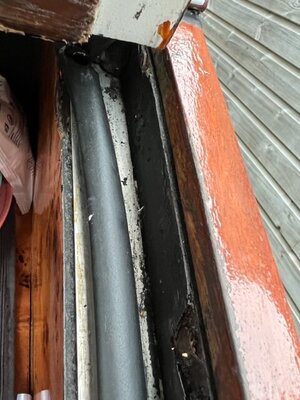

3) Additional view of the swollen, delaminated ply.

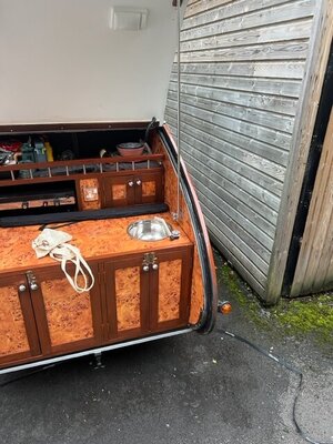

4) Alternative view of the plywood wall of the caravan on the same side as the water ingress at the seal. You can see the deformation of the ply where it has delaminated down its length.
My intent is to make the delaminated ply good (epoxy resin is the current thinking) and then to seal the sides where the ingress is occurring (I'm not above taping at this point if it saves the side). Ideas as to how to achieve both of these aims, as well as any and all insight will be gratefully received with sincere thanks.

As a boat owner of many years standing, that play is probably exterior grade ply. The ONLY solution is to cut out the section way beyond the damage, you need to replace with genuine BS1088 from someone like Robbins of Bristol... The issue is that proper BS1088 (rather than imitation is very expensive. Two 8' x 4' 18mm sheets cost me nearly £1000 in 2009

You cannot "re-laminate" delaminated plywood. Replacement is the ONLY option.
Sadly I think you have just discovered why the previous owner sold it!
In addition, from the pictures, your teardrop appears to be made of OSB (opposing strand board) which many refer to as "kipper crate" and not plywood. Also the location of the seals clearly (to my eye) shows that they could never prevent water ingress into the top edge of the side panels, both of which would suggest to me that its a home build not a commercial build.
Good luck with your repair.
