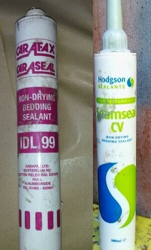

Cheers for the fast reply. I was toying with the idea of re-sealing the rails regardless but didn't want to open a can of worms. Reading your reply has re-enforced that idea.
Edit: Any recommendations on sealant?

I took a look this morning when I did a search before posting. Tidy job, I need to find a dry building to get the work done in. Not sure if I missed it on the thread but which sealant did you go with?

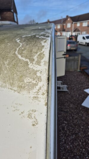

A roof strap leak , can cause water to run down above the foam insulation and down the side wall until it hits a frame member thats not sealed and moves to the inner wallboard and presents itself a lot lower down.The way the caravan was stowed ( slight constant tip to the left) can cause this. To check the window frame seal , remove the window and clamps and the cover strip and the window gasket , then look a the frame surround , if rotted (which if the lower wallboard is spongy its 90% it will be , remove it and replace with 23 x 47mm timber and before refitting the window gasket , seal it with Soudal Fix All( black). When having refitted the window gasket ( they will have used staples to secure the gasket in place and they will probably be rusted , a sure sign of damp ingress , peel back the lip and apply more Soudal ( this prevents water getting underneath the seal by capillary action). Excessive Sealant can be cleaned off with Brake cleaner or IPA

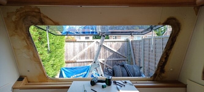

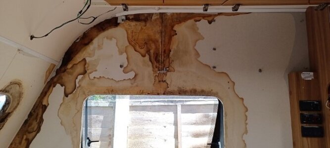

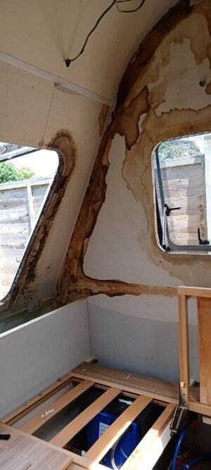

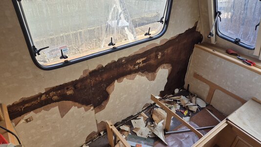

Think you nailed it. Live update.
Roof rail above area come away. Water travelled exactly as Ian described. Let's get to work :ROFLMAO:

Thats a big job , a workshop would charge about £800 to a £1000 for the work, as its very time consuming . I use a multitool to cut through the affected areas , its very surgical , Take a lot of photos to detail the framing as you cut it away .You will not be able to match the exact wallboard pattern , there are many suppliers of vinyl wall coverings for caravans rather than buy the prefaced wallboard , which can be applied to plywood . , Park and Leisure do an extensive range so you could get a close match, I pretreat the frame members with Thompsons water seal before assembly-just in case. good luck and keep us posted
