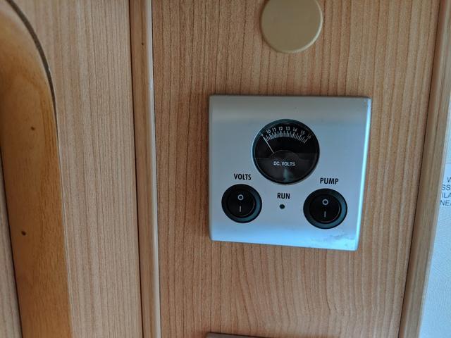

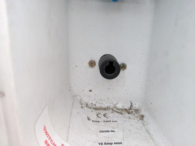

(1) How do i switch between battery and main power (or is it automatic?) There is what i assume to be an isolatioon switch (pictured below if i have added link correctly) however the internal lights work with in switched either way, without any external power added so what does this switch do?
(2) How do i charge the battery (if/when needed) - does it do this automatically when towing/plugged into mains or should there be a selector switch somewhere? (as some advice/guides suggest)
(3) I was looking for a panel with battery levels and some other info (such as a charging selector maybe?) but all I can find is the image below - I'm assuming the switch on the left (Volts) is to show the battery level and this looks good as it shows around 13 when I switch it - do I leave the switch off and just switch it on briefly to check the levels, or do I need to leave it on in use as a kind of master power switch? I know the switch on the right is for the water pump (and assume I leave that on when in use, perhaps turning off overnight)
(4) Advice online suggests leaving the fridge plugged in the day before going to allow it to cool down on mains power rather the draining the battery on start up - i have turned it on and left a can in there to see if it gets cold but is there a way to know its on? It doesn't seem to have any LED or similar (its a Thetford N80) - i have turned the selector from off (0) to the mains powers symbol (battery and gas symbols also available).

(1) How do i switch between battery and main power (or is it automatic?)There is no switch on the Adria There is what i assume to be an isolatioon switch (pictured below if i have added link correctly) however the internal lights work with in switched either way, without any external power added so what does this switch do? That switch is or was for a motor mover do you have one fitted?
(2) How do i charge the battery (if/when needed) - does it do this automatically when towing/plugged into mains or should there be a selector switch somewhere? (as some advice/guides suggest) Again no switch Charges when plugged in
(3) I was looking for a panel with battery levels and some other info (such as a charging selector maybe?) but all I can find is the image below Thats all you have - I'm assuming the switch on the left (Volts) is to show the battery level Correct although not accurate 100% and this looks good as it shows around 13 when I switch it - do I leave the switch off and just switch it on briefly to check the levels, or do I need to leave it on in use as a kind of master power switch? Not a power switch use as you like I know the switch on the right is for the water pump (and assume I leave that on when in use, perhaps turning off overnight) Correct
(4) Advice online suggests leaving the fridge plugged in the day before going to allow it to cool down on mains power rather the draining the battery on start up - i have turned it on and left a can in there to see if it gets cold but is there a way to know its on? It doesn't seem to have any LED or similar (its a Thetford N80) - i have turned the selector from off (0) to the mains powers symbol (battery and gas symbols also available).Not quite sure,mine has an LED panel with buttons to control power selected so probably a different model

The item in the photo is an isolation switch for a motor mover.
The voltage switch on the first photo is simply there to check the battery voltage, it should be sprung loaded to return to off after pressing to check the voltage, and by the way, those gauges are very inaccurate, best using a multimeter.
That's interesting Damien, my switch isn't spring loaded. Turn on, turn off. Now you got me thinking, off into the van tomorrow. !

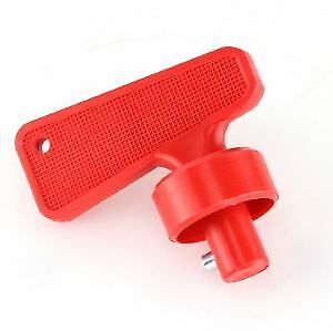

So regarding a motor mover have you got a key that looks like this amongst your keys for the caravan....
....and a mover behind each wheel ?

The image of the isolator switch may not necessarily be for a motor mover it could just be a stand alone battery isolator switch for which he will require a key
