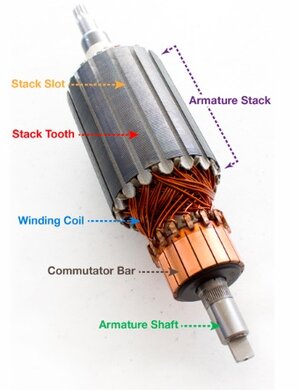

Overcurrent implies the motor is at fault ( or output cables) not the driver , the electronics have detected the overcurrent , and shut down to protect the driver transistors.Based on my experience with motors I would say a winding on the armature is shorted to another winding. To check this the armature needs checking with a v low resistance meter , rotating it round and looking for a small change , The other way is to observe the armature, looking for burning/discolouration and at the same time cleaning up the commutator bar surface (and gaps). On the slight chance a MOSFET transistor has shorted , then disconnecting the motors and running the mover would show the same fault ( had this with a CNC punch machine), but again having dealt with lots of motor drivers and switch mode power supplies the driver transistors tend to explode as a damaged transistor is a lot faster than a fuse. The final cause would be a damaged gearbox , this is usually a failed bearing ( v rare) or shattered teeth and would create a grinding noise. I carry a spare motor assembly to check out the system along with a DC clamp on ammeter.
