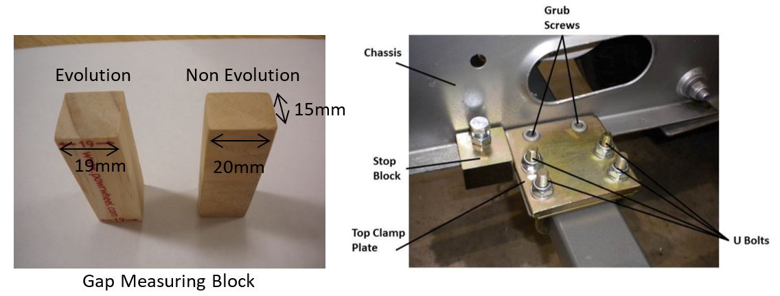

If it's "slipping" check the distance between the rollers and the tyres should be 20mm.
How to adjust.
