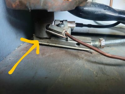

See the photo here:
The burner assembly on the backside of the Dometic RF60, where the yellow arrow is pointing on the photo can normally be dislodged from the vertical pipe, it's attached to. This is normally doable by loosening a screw, and then the burner assembly itself should be able to pop right out by pushing it down.
But this is just not possible in my case. It's stuck as in not movable. I've tried whatever I know - WD40, light banging, light wiggling using tools and so on... it's just stuck, so I can't get in to the burner itself and see the status regarding the debris.
