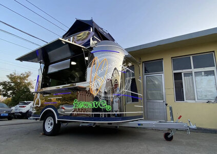

If the trailer, which is 4m long and weighs 1000kg, can this type of system be used and pass safety tests?
I have attached a photo as a reference. I understand that AL-KO is a higher quality, but it’s not a necessity, right?

At that weight, it'll need automatic over-run brakes, a break-away cable, a parking brake and automatic reversing - from the photo that trailer doesn't appear to have any of those - it looks more like an unbraked trailer which is only permitted up to 750 kg.

The finished product will look similar to this. I have paid extra to make sure it has a brake system and that the trailer hookups to the car meaning the lights are synchronised.
It’ll be classed as a O2 trailer as it’s over 750kg. It will be a single braked axel too.

It looks as though ir may be from North America in which case it would have a 2” hitch instead of a 50mm one. In that case it would definitely need a new hitch.

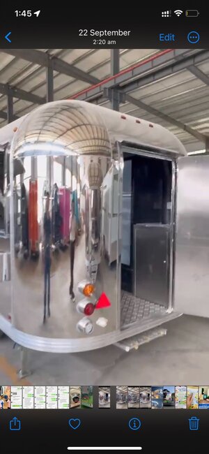

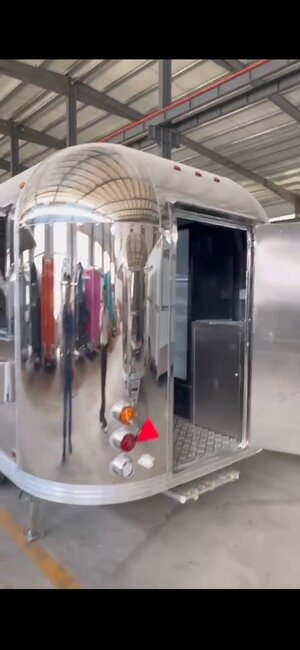

The rear of the trailer looks like this and the lights will be synchronised with the car, so I hope everything will be fine when it arrives at the port in around 8 weeks.

Thanks a lot for this! I think they are missing the registration plate light, so I’ll need to enquire about this too.

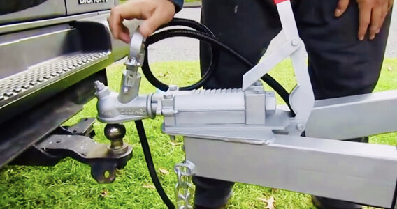

After some research, I have found the exact type of coupling system installed on my arriving trailers. From what I know, it is a braked system however it does look different to ones seen in the U.K. which have a black coil-like rubber material just after the hitch.

Have a look at these two company websites. They supply towing equipment for a wide range of trailers. They also supply a range of trailer parts. It may be that they have a coupling like yours and could answer any queries and importantly give you confidence that yours can be used in UK
PF Jones
Western Towing.

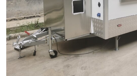

My only issue now is that there’s no breakaway cable. I guess that chain just provides extra security.
But if the trailer was to become unhitched while the car was in motion, the brakes wouldn’t turn on, which from what I have read online is the law.

Also sold on Amazon U.K. too but unbranded.
Seems to be popular in Australia and it’s listed as an over-run one.
My understanding is that the reversing mechanism has to be automatic - UK caravans used to have a similar device as your link back in the '70s but the law here has changed since.

To my understanding and after reading the IVA inspection notes, everything is fine.
The coupler has an overrun brake. It’s got a 50mm ballpoint. It has a breakaway cable (which is not legally required as it’s under 1500kg) and has a secondary coupling device (the chains).
However, I did find another fault with the rear of the trailer. It’s missing fog lights so I need to rectify this.
