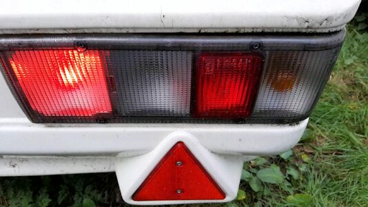

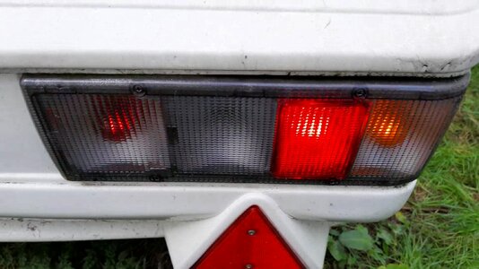

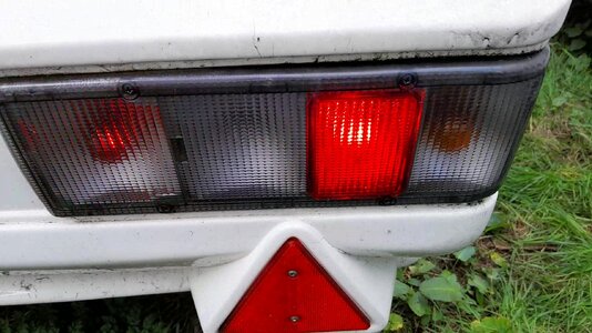

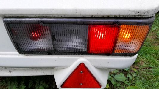

Hi all.
I am hoping someone who may know what the issue is with the rear towing lights on our caravan.
I have attached photos of our issue, as I don't know how to put a video on here.

It looks as though you may have lost an earth - and given that your pictures are of the offside it s most likely that the missing earth is on the nearside.
It would be helpful if you could explain exactly what the lights are doing in the pictures - you know do but we don't.

As with Woodentop, most road lighting issues boil down to corroded wire terminals in the light fittings, or poor connections in the towing plugs and sockets.
And likewise, the pictures tell us nothing, as we don't know what you were expecting them to do, or how you think they are misbehaving.

When the side lights are on, the indicators work fine but when you put the foot on the brake pedal in the tow car, the fog lights come and the side lights and indicators go off, then
when you release the brake pedal the side lights and indicators are working fine again. This happens on both sides, got a new plug for the caravan today and going to replace the old one with the new one, hoping this may sort the problem out.

Sorry for not replying sooner, due to getting this issue sorted, as we need the caravan for a sad trip to Doncaster for my sister-in-law's funeral.
Update:- The towing electrics have now been sorted. It turned out to be what a lot of
you had said, bad earth so we re-wired our Shogun's 12N socket with a pre-wired socket and wired straight to the wiring loom the plugs into the lights in the rear bumper and all lights on the caravan are now working as they should.
Thank you all for your help and advice.
