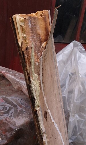

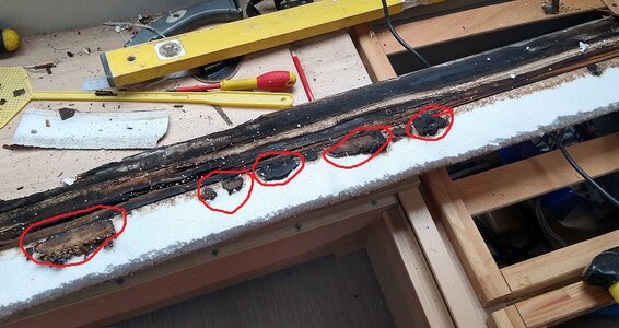

To remove these 'hidden /unaccessible screws I use a diamond coated blade of a multitool to cut the screws . Once the front shelf is removed you will see the front framing for the windows/gas locker hinge and I would put money on this framing also being wet/rotted, A mobiler engineer will probably charge in excess of £1000 to repair the damage , if indeed they will touch it and workshops even more. If you are really lucky and the front framing is not damp/rotted . B & Q stock 15mm thick vinyl covered mdf - oak furniture board and this can be cut to size to fit inplace of the old . I use expanding PU glue to help attach and secure the board to existing framework and firewall, you can also a nice piece of corner trim to provide a lip for the new shelf and hide the screws( it gets glued on with PU glue). Take lots of photos of the caravan at various stages of stripdown as this will aid you when coming to the rebuild.attached are two photos of one of the repairs I did in 2024 the front shelf was rotted where it touched the front wall of the caravan , the other photo shows the upper front framing piece which supports the window hinge (this was an Elddis Xplore with a single front window) the areas highlighted in red are not timber but lumps of fungus growth which only became visible once the window and window rubbers were removed to expose the wooden framing. The whole of this caravan's front interior and two more like it in that year, had to to be replaced entirely.
