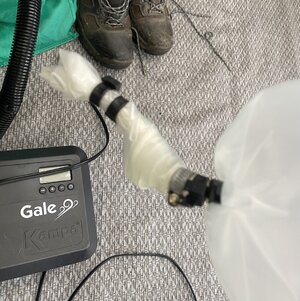

The middle bladder in our Isabella Cirrus awning burst yesterday on the end, I’ve bodged it up by crimping the end closed with a jubilee clip and cable ties. Rang Isabella today, won’t entertain a warranty claim as it’s outside that and won’t sell me one directly BUT did tell me the part number and RRP so I can ask one of their stockists to order it for me.

I inflate it to 5.5-6psi but as it was going to be hot on Sunday I dropped the pressure before we went out. It still held shape but not exactly “robust”. Yes, the bladders are very design-specific with a bend in them, air inlet and two unions for the adjacent tubes to attach to, so not exactly a simple design. £159 though……. Enough to make someone as tight as me cry! 😂

No, very different materials plus the tear is about 4” long at the end. My makeshift repair holds air for a few hours though with a jubilee clip and cable ties pulled very tight round the end so we should be okay for the week.

In my personal experience re sealing the end welds is impossible. I have tried each and every method without success. Tape and glues of all types and descriptions none worked. Now I carry spares but if I remember I only paid around £40 for a main upright bladder for my Dorema Magnum.

Tape might work if it split lengthways but it’s a problem if it splits at a welded seam as ours has as it’s difficult to get tape to seal properly around the seam.

A jubilee hose clip and cable ties keep it airtight for 8 hours as a temporary fix. Another jubilee clip or two would give a better seal but I can’t find anywhere local that does them, the nearest Halfords is 25 miles away!

You need to ask yourself why the awning ripped as it may be a design or manufacturing fault. In which case you would be claiming from the supplier for a new bladder.
It failed on the welded seam on the tube end so quite possibly weakened during manufacturing but the dealer isn’t trading and the manufacturer isn’t interested as it’s out of warranty. For £159 I don’t have the energy to try and argue the case.
