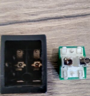

T toad a caravan Sep 23, 2023 1,065 408 1,435 Tuesday at 1:45 PM #3 The mains (Green) wasn't so free,replaced rest whilst at itL/H spring rust apparent once I'd replaced it with new one Last edited: Tuesday at 1:52 PM Reactions: Mr Plodd
