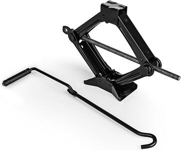

Hi, fairly new to the caravan world after upgrading from a VW T5 (self-built) camper, did our first trip away last weekend at Carsington Water (Great Site). Everything worked well, apart from having the wrong pegs for a hard pitch. The only thing we found is the caravan still rocked a bit when walking up and down, the steadies were all down and nipped up, i didn't go too mad as they appear to be attached to the floor not the chassis.
The van is a Coachman 580/5, so it's quite long, I think about 7.4m total, and I have seen some talk about stabilising jacks that are put underneath the chassis, once levelled.
Does anyone have any experience of these?

You could use these. https://www.vevor.co.uk/rv-jacks-st...el-camper-leveling-jack-4-pack-p_010897531715
Usually used on static caravan homes . The issue will be where do you place them ?Floor 👎,chassis 🤔 axle 👍.

The caravan will still be on its wheels which together with rubber suspension bushes on the trail arms of the axle will allow some movement as the weight shifts. The rear steadies are on the rear legs of the chassis and with the front steadies and jockey wheel should brace the caravan, try tightening them up a bit more next time. The steadies can take a lot of force , just don't try and jack the caravan off its wheels !

As above. Most of the weight is carried on the wheels through the suspension. So some bounce is to be expected. I use cheap scissor jacks. (I would not use them on the car), under the chassis close to the wheel. I put them in after levelling up. It helps. Or what Dusty suggested in #2.
