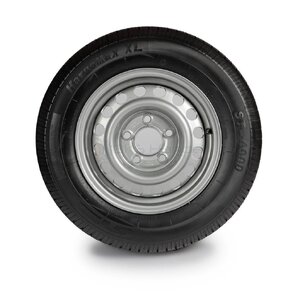

Tyres are more an age thing, some will run tyres to three years and change, some will run to 5 years and change, others will till seven + years but as they get older we don’t know what is doing on inside, friend didn’t know what to do but decided to change the tyres, she said that when the tyre came off there were signs of the tyre (internally) delaminating.
So at what periodicity do you have your tyres removed and checked? Were your friends tyres budget or quality make and what age?
Good question as generally caravans are fitted with the cheapest budget tyres which is probably why they need to be changed at 5 years?
I think most caravan tyres from manufacturers are generally a budget tyre.
For me personally I check the outside wall, inside wall and between the treads each trip, if all is well they stay on until 7 years old (from date on tyre) if however they are showing signs of deterioration then they get changed.
I don't think there is anything such as a "caravan" tyre and manufacturers have a choice of what tyre to put on a caravan. Perhaps it is time that mid range or even top of the range tyres were an optional extra allowing the consumer a choice?
There are specific tyres made for trailers. GT Radial and Kenda make them. They are embossed on the side wall “FRT”and often have “Trailer use only”. Hopefully you can make out the wording screen not easy in sunlight as I’m at Game zFaire IMG_0407.jpeg
