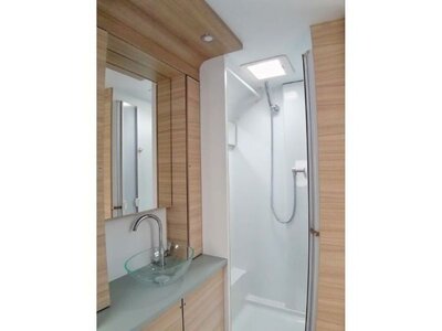

Hi there!
I was interested in who else has issues with there bathroom sinks. For some reason this seems to be a common issue in a few motorhome models, either inconveniently oversized, discoloured or cracked.
