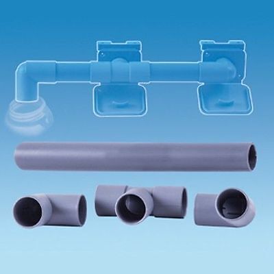

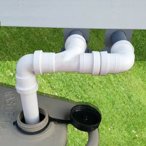

And using some of Clive’s pipe you can make one of these with the white parts from most diy or Screwfix stores
The pipe is 32mm as all metric pipes are measured in OD. You can buy it by 2m or 3m single lengths from Toolstation.

#3 shows solid pipe, not flexible, hence why some may consider a hardware retailer rather than a caravan dealer?
Certainly if I wanted a solid pipe waste drain Screwfix would be my first port of call. But that’s doesn’t detract from the fact that in my initial post the pipe was flexible and referred to as 28.5 mm by the leisure equipment retailers.
