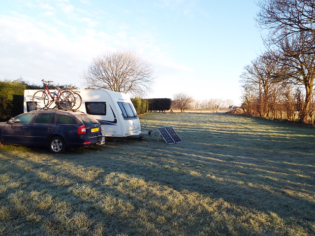

I use a 150w folding solar panel, does OK for me, keeps battery charged up for long stays off grid, even shorter stays in winter.
Took the croc clips off the panel cable and put on a plug to go into the caravan 12v solar socket.
