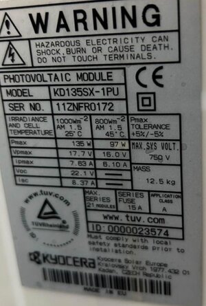

I've got this panel available to me.
Would it be suitable for caravan. It'd only really be for keeping the battery charged not Looking to go off grid

Looks like it's 135w, so more than enough to keep a battery well topped up. You just need to think about
A) Some form of controller so you dont "cook" the battery on a sunny day
B) Where are you going to put it? If permanently on the roof you will need some suitable brackets/mounts. Also don't forget the weight, thats 12.5 kg off your payload , which on many caravans is 7.5-10% of the total!
