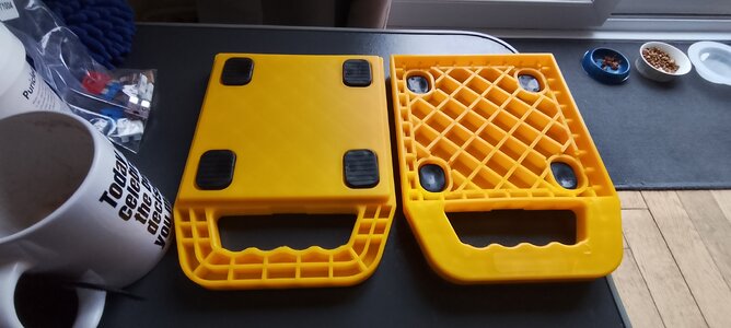

I bought these plates to stand the caravan steadies on our grass pitch, which way up should I place them, honeycomb side up or facing down?

Old bit of Decking planking or wood 20mm thick , that way if you forget it not much lost. and definately honeycomb side up otherwise you will fill the holes with soil and grass which when you put them back in the gas locker and forget until next year you may introduce creepy crawlers or moulds and other organic lifeforms

Looking at them, honeycomb side up as they have rubber inserts which looks like they should be fave down onto a hard surface.

They are only honey combe to give the product enough strength, together with lightness, to function where it is constructed of a material with an inherent low strength. Plus of course to save the maker material and associated costs.
Its not a design attribute other than in those respects.
If used open side down it then partly defeats the load spreading using a pad at all aims to do and as already pointed out could so easily pick up soil debris, partly negating the weight saving.
Used, open side up then it is more likely to get water build up but that at least is more readily removed.
I suppose having them makes a different on site "statement" to those that use other things does.
I am in the use a bit of suitable wood camp. Certainly not a bit of pallet plank as these tend to be cut from the lowest quality wood with a high probability of having poor cross grain strength.
Decking though that inherently ought to be reasonably strong for its intended duty, or better still thick marine ply or even exterior [roofing or shuttering] ply make for a way better choice.
