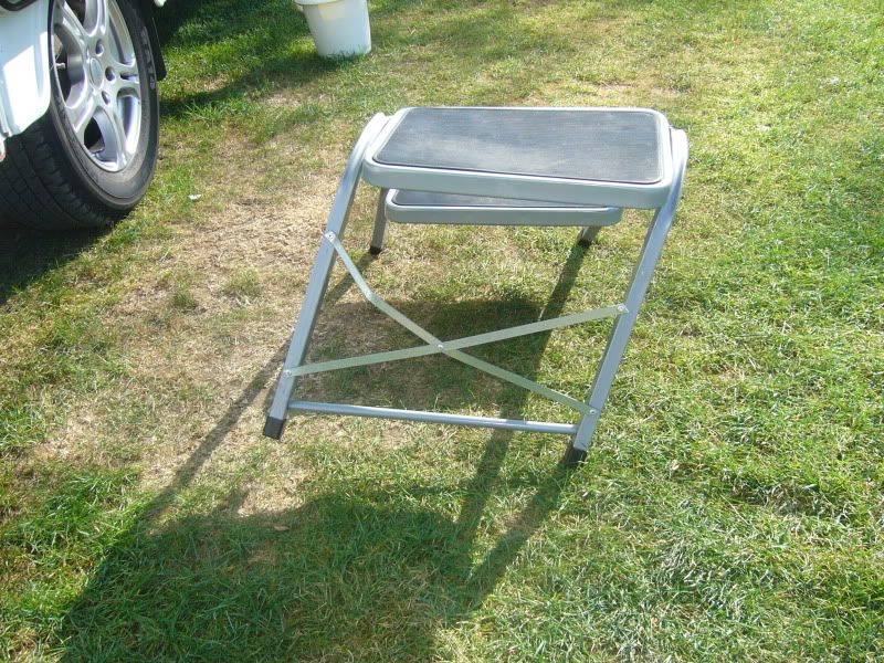

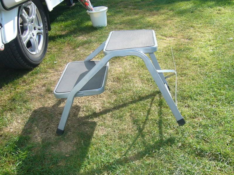

A timely reminder to you all to check your steps as I had an accident Friday night when stepping out of the van. My steps quite literally collapsed and I was sent sprawling, bruising my ankle and hurting my back. I spent the evening with my ankle elevated and wrapped in towels and ice blocks and was very shocked by the fall.
You will see by the attached photos that the steps are neither old nor rusty and allegedly comply to BS EN14183. We bought them approximately two years ago and are only weekend campers so they have hardly been over utilised. I know I'm no lightweight (12.5 stone) but I can't believe how the rivet has sheared off and the frame twisted to such an extent. A more elderly caravanner could have come off far worse, so please take care.
http://img.photobucket.com/albums/v396/TigzPics/P1040029.jpg
http://img.photobucket.com/albums/v396/TigzPics/P1040028.jpg

Your photos do show a twisted mangled wreck of a step. Very worrying and I hope you are OK and on the mend.
To be fair they do look cheap and not of a very sturdy construction.

Just returned from a dealers in Salisbury and noted what appears to be your type of steps; complete with the EN label.
The cross stays are now welded into the rear legs in a much more robust method of construction.
You have a concrete case to get yours replaced free of charge by your dealer as the maker has all but accepted by making such a change that the way they were made is not fit for purpose. Importantly this is a safety issue not a simple durability or wear and tear issue.
If the supplying dealer will not play ball go to the maker/importer and reference this web site. If neither is co-operative then Trading Standards.
These are durable goods and so ought to be safe way beyond any warranty period.

Valerie,
I was interested in your post as my wife had potentially a serious fall about 4 years ago. In this case she slipped on what was a wet step early morning falling backwards onto the step. In her case it was a combination of wet step and sloping pitch.
My first comment is to agree with an earlier post that suggested you had redress on your supplier and I would suggest that the term "Fit for purpose" comes into play where quite obviousley this product would not qualify.
Secondly looking at your photo's the height of your step appears to exceed the width and in my opinion I find this to be a design fault, I do not feel any step can be so out of proportion and be safe. I believe a safe step should be wider than its height. Its all very well it being stable in the shop on level ground but many pitches can be on sloping, uneven and sometimes soft ground which can result in a wobble when your weight arrives sometimes with disatrous consequences and if you have ever seen a loved one flying through the air in such an incident I am sure more care would be excercised when purchasing what on the face of is is a mundane item yet so fundamentally important to life and limb.
