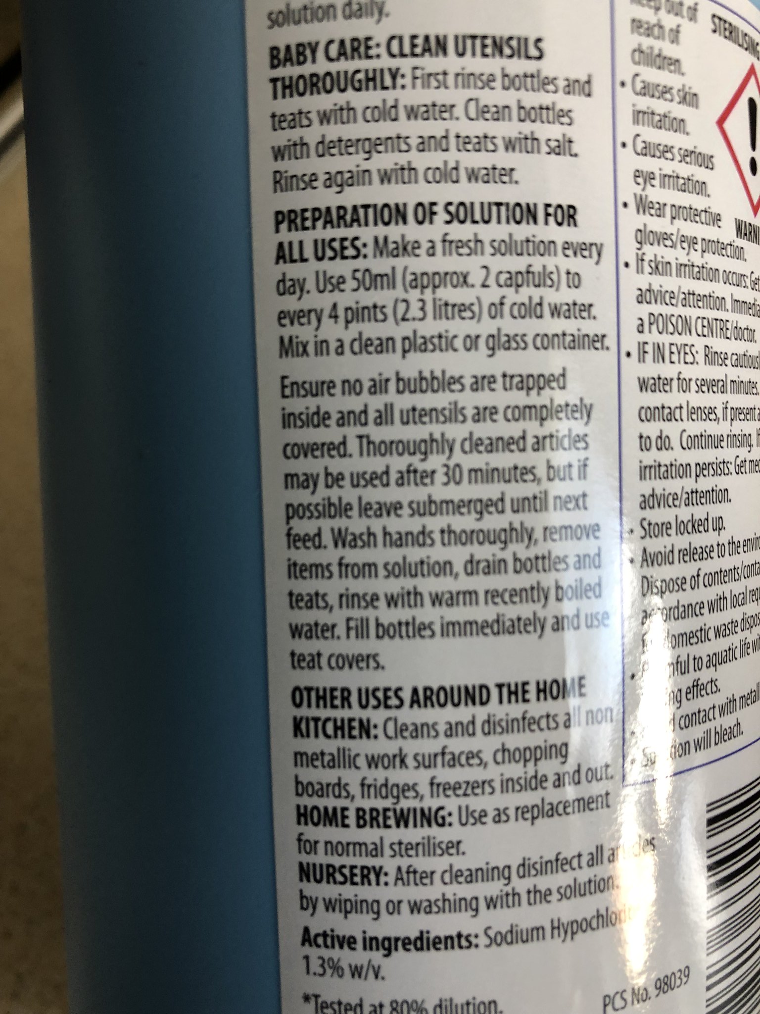

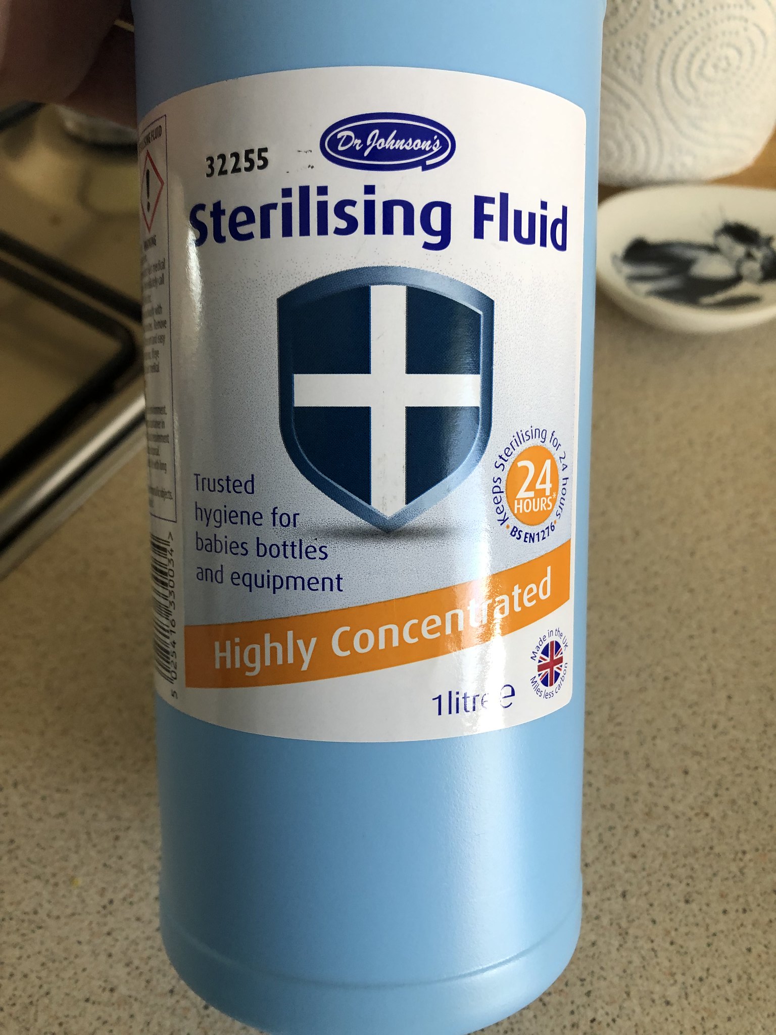

I thought i`d sterilise the water system before we get started so i bought a couple of bottles of this stuff, plan being i`ll fill the aqua rolls up put this in it and run it through the hot and cold taps for the kitchen and washroom sink.
I`m not sure how much to put in (40 and 25 litre aqua roll) and advice appreciated

I only use clean water to flush my system through. The sterilising fluid you have, can cause internal damage to the water heater and its components, if left in the system for too long.
Others will come along and offer their own opinions, but others will also agree with mine.

I agree with Lappy. Milton and other chlorine based sterilising products like yours will pit metal if left in contact with them for too long. By all means use it in your aquaroll and wastemaster and then rinse out, but I would caution against running it through the van. If you have a water filter in situ , it will also damage that. You can buy specific products for caravan internals such as Puriclean.

However you did ask two other questions, How much would you need? That depends on what applainces you have in your system and the size of the caravans, but a 25L water barrel full shoudl be enough. As to the dilution, the infomation is supplied on the instructions for the fluid as shown in the pictures you have supplied.
2 capfulls for every 4Pints or 2.3Litrres therfore a 25L water container (25/2.3) x 2capfulls = 43 capfulls
