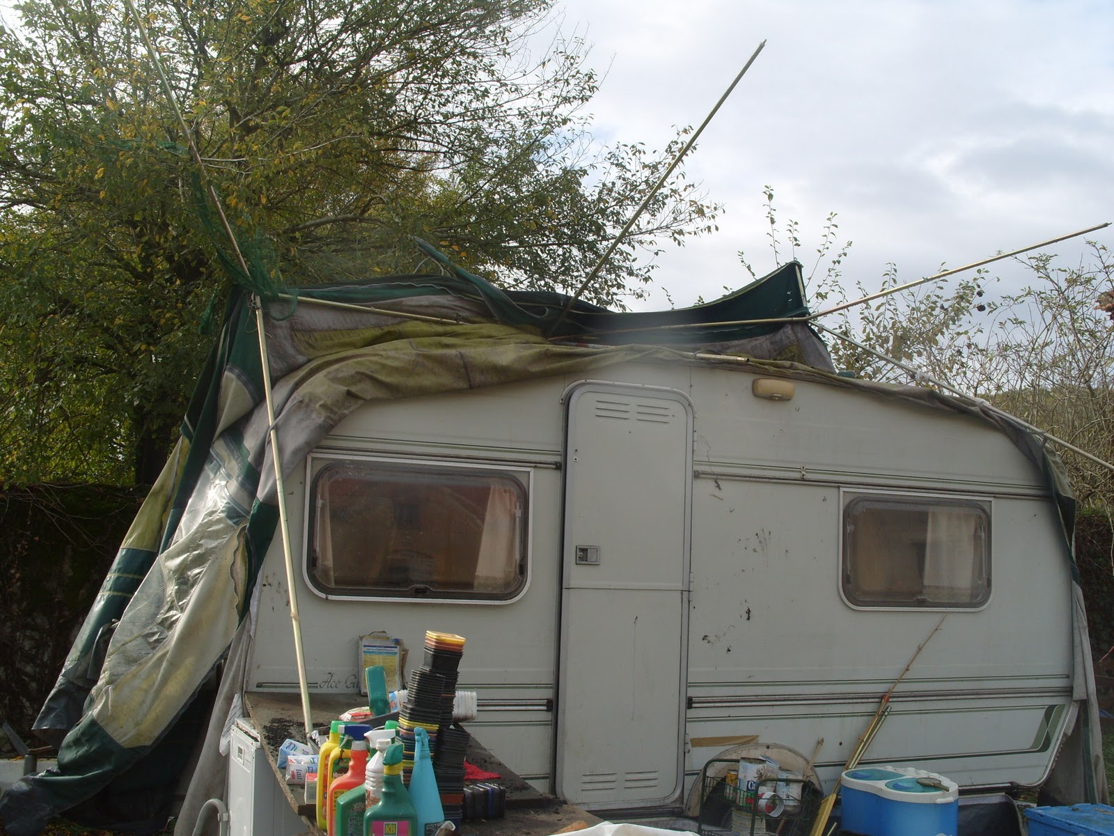

293
Read this post by Lord Brakewynde and you will see why storm straps are necessary.
http://www.practicalcaravan.com/forum/uk-parks-touring/new-england-bay-0
