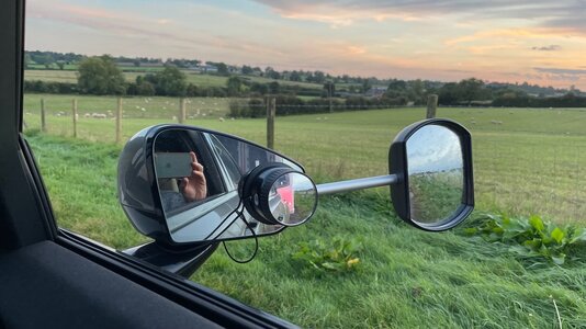

I am using Suck-it-and-see Delux. My Polestar has frameless mirrors so there is nothing for my old Milenco Aero Grand to clamp on to.
The Suck it and see are WAY better than the Milenco. They are just as easy to fit, Infinitly easier to adjust (as they move with the glass in the mirror), offer just as good a view, and weigh about 1/10th of the Milenco grand. I wish I had found them sooner.
We have towed about 2,500 miles with them, and had one fall off once, the second time we used it (held by the safety cord) - I hadn't fitted it properly. Lesson learned and I test them once fitted to ensure they are solid - they are.
The Delux version that I use have a mirror on the suction handle that works as a blind spot mirror, as well as the main surface of the extension mirror and the remaining glass on the car mirror. Lots of vision opportunities.
Delux with Blind spot mirror
I still have my Milencos if anyone wants to buy them. - DM me!

Suck-it-and-See mirrors don't have type approval. That means the existing outside rear view mirror is the only type approved outside rear view mirror on the vehicle, but the base of the Suck-it-and-See obscures part of the field of view of the standard mirror thereby rendering its type approval null and void. As a consequence Suck-it-and-See mirrors are actually illegal.
Besides, in case the extra load imparted into the mirror adjustment mechanism by the Suck-it-and-See mirrors attached to the mirror glass could cause premature failure of that mechanism or of the adhesive bond between the mirror glass itself and the mechanism.

Suck it and See are E11 approved. Is there some other type approval that is needed? On my car, the mirror glass is an integral part of the mirror housing. The entire housing moves to adjust the mirror. The extra load from a suck it and see is _much_ lower than a Milenco mirror as its so much ligher, and has a much lower wind profile. In addition, there is an integral blind spot mirror on the suction mechanism giving further visibility.

In that case I apologise for misinformation. (Suck-it-and-See mirrors didn't used to be type approved). Of course, if the mirror glass is solidly attached to the housing and the entire housing moves when the mirror is adjusted (which is rather unusual) then the reservation that I had doesn't apply. In most cases, however, only the glass is adjusted.

The Polestar is a bit (quite a lot) unusual in that sense! It does make for a simple and effective towing mirror solution though. You can mount the suction cup very close to the edge of the mirror without worrying about fowling the frame (as there isn't one). I have to admit - I was worried when I ordered the car that mirrors might be an issue (having been used to the Milenco clamp type for 12 years). It was a pleasant surprise to find how easy they are to use.
I also have to admit that I didn't know type approval for mirrors was needed until about 2 weeks after I bought the Suck-it-and-See. I had to go out and physically examine them to double check the E11 mark was present! It is :) . I will post a decent picture of them attached to the mirror at some point.

From the pictures and description from Tobes his Polestar mirrors have virtually no outer frame. The appear integrated to the housing.
Thats because on these cars to adjust the mirror, the whole housing moves, where as on most vehicles the glass moves within the housing.
The glass is supplied as a separate part to the housing.

I would not think so, just that he the glass is held into the mirror by the entire "frame" (its frameless so having a frame is a bit odd).
