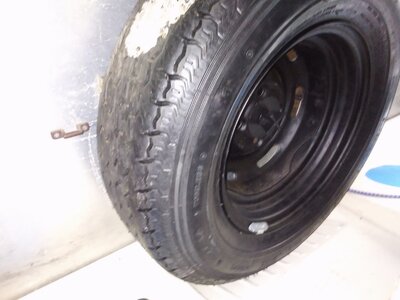

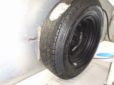

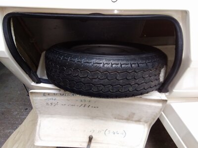

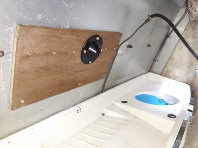

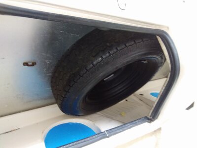

I recently fitted a swift spare wheel holder into the front of my 1992 Abbey GTS,,this particular model has two locker doors instead of the usual single...It is was an awkward process initially,I noted how I fitted it,removed it and then took images as I replaced it,I will post the images I taken,l realise your caravan design will be totally different than mine but hopefully the images may assist.Gary

It's ok once I found the technique,it's only a small 2 berth I've got and their isn't an abundance of spare floor space,what with a recently acquired awning, hopefully with carrying a spare I won't need it..from what I have gleaned I didn't fancy the Alko .good luck and enjoy the holiday...Gary
