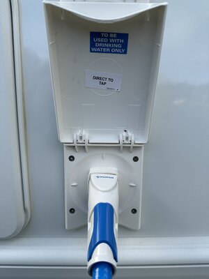

We are at present sitting in Dunbar at a fully serviced site and connected the main water tap with the long hose which was supplied with the caravan to the lower intake connection (non pump version)
Am I right in saying, if we wanted to use the onboard water tank, I’d need to purchase the same type of hose but the end is a pump version (which has the 2 metal elec pins)?

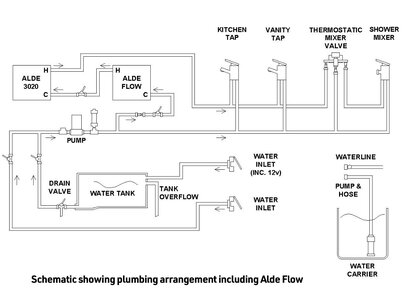

I thought we decided that you could use the water pipe direct from the tap, and fill the onboard tank. Looking at the diagram , it would be possible.

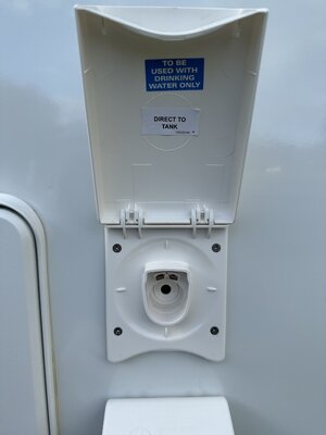

Ok so even though the hose I have doesn’t have the metal pins on the end (pump version) to help draw the water, I could still connect the tap hose to the on board tank inlet.

Just put the mains hose directly into the ‘direct to tank’ connection, turn on, and wait until the overflow dumps water to under the van.
The tank will now be full. You will now need to alter the valving in the van so you are using the tank water.
Then disconnect the mains hose, drain it, and store it, so you can top the tank up tomorrow. (If the tap is not frozen, wrap it up).
You would only need the pin connectors if you were using a submersible pump from a barrel.

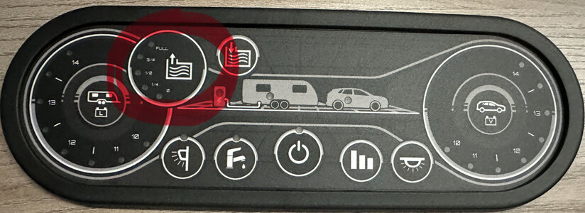

There may be a switch inside the caravan that has "Ext" and "Int" marked on it. to fill the onboard the switch needs to be turned to "Ext". Once the tank is full move the switch to "int" to use water from the onboard. We are assuming that the outside water tap is turned on to supply water to the caravan?
No there isn’t a switch, not that I can see anyway, just on the panel where the tank is shown, as pictured

Your diagram shows a tank outlet overflow which is more reliable than a float cut off which could be adversely affected by road defects or tracks into CL/CS etc. Also a tank with a float valve would still need an overflow pipe just like your domestic system.
