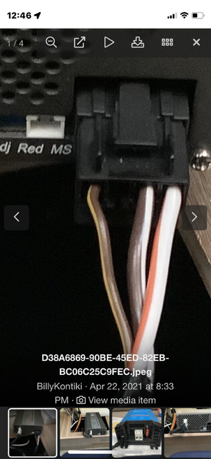

Hi everyone,
I have a 2013 Swift Challenger caravan and want to swap the Sargent PX300 charger over for a Victron IP22 as the former is not compatible with my Lifepo4 battery.
I know this topic has possibly come up many times in the past and to be honest, I think I have read them all but, still remain confused.
I don't wish to make a mountain out of a mold hill but I am looking for a straight answer from those that have successfully installed a Victron IP22 replacing the Sargent PX300 charger.
I'm fine with every step of installing the IP22 right up to and when it comes to that brown third wire that runs parallel with the battery positive and negative wires that as I understand goes to the control panel above the door indicating shore power connection with the lightening bolt icon. I could just disconnect this wire however, I would really like to maintain the visual on the control panel. If anyone can advise me how to go about his I would be eternally grateful. The situation is compounded by the fact that the Victron does not have a port that I could connect this wire to. I could bite the bullet and engage a sparky but figure it can't be rocket science.
Many thanks, Les

I know someone who used a plug in mains adapter to send power down that wire when the caravan was connected to EHU.
Guess you measure the voltage on the wire when on EHU and then get one to suit

At this stage I think I will just sit on it. The worst case scenario is if the charger is not compatible, it will eventually destroy my battery (an expensive exercise). If that brown/yellow MS wire wasn't in the equation, there wouldn't be a problem.

I propose to conduct one a further test before I make the decision in going with the Victron. I will leave the PX300 in situ however disconnect both positive and negative wires and run them directly to the battery leaving the brown MS (mains supply) wire attached to the charger. I should in theory only lose the battery state of charge information from the control panel above the door. By doing this, the PSU is bypassed and again, in principal, should provide a better charge. This procedure has been done by another owner with positive results although he disconnected the MS wire as well.
