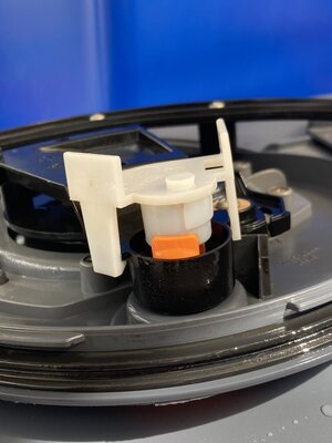

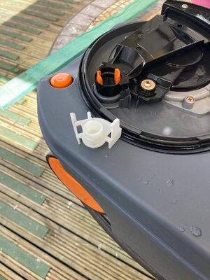

Firstly. have you removed the item #4 Waste-Holding Tank Plate from the Waste Holding Tank?
Coincidently, I still have my cassette at home after giving it a deep clean so I can open it up again to see how item #15 is located and secured if necessary.
There you go, here's a picture of #15. It's just clips on but it might be difficult trying to refit it if you haven't removed #4.
I had to give #15 a quick clean before it was suitable to be photographed as it's a proper gunk trap.
Good luck.

Thanks. I stuck my hand inside the hole and felt around and could feel a round hole. I then pushed it into the hole and it seemed to click into place. Luckily I still had rubber gloves from Covid time so wore them
I am not sure what the #15 does as everything still seem to function okay even with cassette in place and #15 in my hand,
I did not know that #4 etc could be removed and not willing to tackle that job on site, but maybe when we get home?
