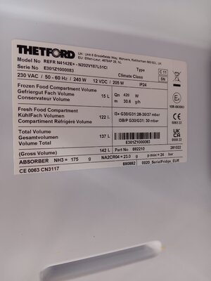

Recently bought a new Mazda CX60 diesel mild hybrid. Recommended by a number of magazines as a good tow car. It tows really well. But: when in transit with car hooked up the fridge won't work. I've had the caravan electrics tested. All OK. The mazda 13 pin electrics checks out OK, without being connected. We've followed the usual routine for cooling the fridge before any trip. My mazda guy is at a loss as to what the issue is. Has any one else had this problem or do you have any suggestions. Ps obviously I realise the fridge should only work when the engine is running, but even then it won't work. Attached is the model number etc.
Graham
