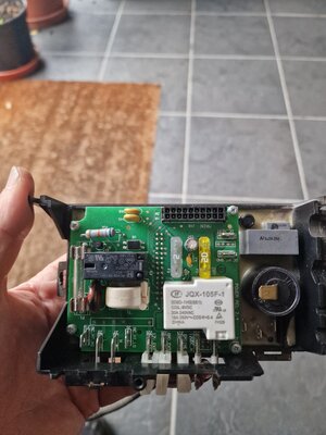

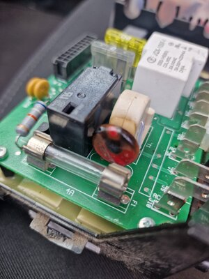

I have a issue with my thetford fridge powerboard pt no 691137.

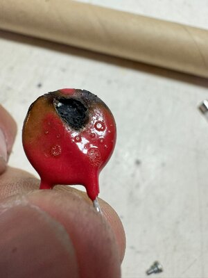

The varisistor has blown and wondered if anyone knows the pt no or resistance info on this part.
Has anyone repaired this or knows who may be able to?
I have attached some photos of the part if it helps
Kind regards
James

It would normally blow for a reason and if you simply replace it, it may blow again.
It blew from a power surge from a generator. I had someone who deals in electronic look at it and tested other components on the board and said all other bits seem to be fine..
The component as mentioned has blown the details away and need to know the resistance data etc to replace it.
