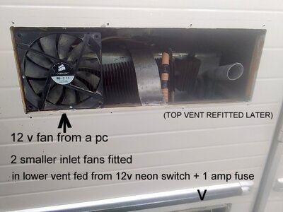

Over the years I have become convinced that they make a substantial difference to an absorption fridges efficiency when the ambient temperature is 25⁰ C or above.
It doesn't need to be expensive, or elaborate, just a 12v computer fan zip tied to the top fridge vent extracting the hot air from the space at the back of the fridge works wonders. If you don't have a fan then a good temporary measure is to remove the top and bottom vents completely as that enables a much greater airflow. A fridge works by removing heat from inside and passing it to the external air. The more air that is flowing across the heat exchanger (the finned thing you can see) the more heat is taken away, so the cooler the inside of the fridge gets. Think how cold it feels in the winter when the wind is blowing, it takes heat away from you.
Many insist on the expensive theromstatically controlled kits from the likes of Thetford and Dometic, and tgey certainly do work, but I just fit a fan and a switch, its simple, cheap (£15 max) and most importantly its effective.
