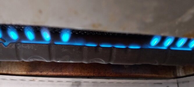

Looking at the grill burner, the flame ignition , gas valve , jet are all at the rear.
I’ve never understood why the centre flames are so poor? Any thoughts Prof?IMG_5911.jpeg

The quality of the flames look OK (no yellowing) so I have to presume the gas air mixture is correctly mixing. But looking at the burner bar, the centre section does have a different form to the ends that corresponds with the change of flame size. I have to presume the manufacturer has designed it to produce this type of flame pattern.
From a practical point of view, the centre section of a grill benefits from receiving additional heat from the adjacent ends, so I'd guess the manufacturer has tested the heating capability and found that having equal flame sizes, too much heating takes place in the centre, so the reduced flame size provides a more evenly spread heat distribution.
My grill flame was very similar to that shown in Dusty's picture, and once warmed through was quite effective.

That’s correct Prof. The centre part of the burner has been that way for as long asI have had a Thetford Spinflo unit.
Realistically I cannot see the reason for the lesser flame burn in the centre. A piece of bread for example will be lesser browned in the centre?
The matter has been raised many times on various forums, yet it is still an unknown Holy Grail🙃.
Your supposition is credible yet still leaves me and others wondering🤔.
I don’t suppose you know anyone at Thetford??👍👍
Not necessarily,
Burning gas correctly produces a blue flame and hot gasses. It does not produce a great deal of radiant heat. The flame on a hob bathes the underside of a pan with the hot gasses which heats the pan, but a grill requires radiant heat, so simply burning a blue gas fame above food will barely warm it.
If a flame starts to burn with yellowing tips, the level of radiant heat produced increases. That's why candles and paraffin lamps lights seem to feel warmer and heat up nearby surfaces so much more.
The trick with a gas grill is to burn the flame under a mesh which picks up the heat (just like a pan on the hob). Provided it gets hot enough it will begin to radiate the heat in the form of Infrared radiation. It's the radiation that heats the food. When the mesh radiates it does so in all directions, so some radiation from will heat food that is just to the side of being directly under the filament of the mesh. If the mesh were heated perfectly evenly all over you, there would be stronger radiated energy arriving at food directly under the centre of the mesh, due to addition of energy arriving from the sides of the mesh. Therefore to compensate for this if less heat is produced in the centre of the burner, the grills heating effect can be tailored to produce a more even radiated output at the food being heated.
As for naming contacts in companies, it's not ethically correct to name or provide direct contact details in public forums without their or their companies permission, and most of my contacts like myself, have to be conscious of sensitive confidentiality issues.

I was hoping for an off the record explanation of the burner design , not breaching anyone’s confidentiality.
I understand radiated energy but not in the grill context? The toast test says it all.
I have given some of the considerations which might affect the design, I did not say the manufacturer got it right!
But have you considered you might not be using the correct bread? :devilish:
