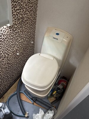

I recently bought a 2002 Avondale with a Thetford toilet, please see pics. I have two problems, firstly it doesn't seem to flush- I'm currently in a campsite and using the pleasure battery, is it possible this is electric flush which only works on mains?! Surely not..
secondly, to put it bluntly it just stinks. I have spent a lot of time cleaning it (it was pretty gross when we got it to be honest) but it seems to be emanating a smell which is like a cross between bad, old BO and toilet fluid. If it was up to me I'd like to get the whole thing replaced! But my partner is a kind of 'fix it' person. Is that feasible to rip the stinker out? I suspect smell may be coming from the cassette deep deep down- this caravan was sitting unused in a field since Covid and- let's just say- the toilet obviously hadn't been cleaned before it was shut up and left 😵‍💫
I'm an absolute newbie and don't know what the heck I'm doing at all so please don't assume I know anything-I don't even know if this is an electric flush toilet?! Please be gentle and explain things like I'm a five-year-old :) thank you 🙏🏼

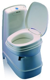

This seems to be your model
Thetford CASSETTE TOILET C-200 CWE featuring a swivel bowl
Thetford C200 CWE Toilet Features:
  • Colour White
  • Flush 12 volt electric
  • Integrated pour-out-spout
  • Integrated flush water tank
  • Waste cassette capacity: 17L
  • Flush water cassette capacity: 7L
  • Access door and water fill door are optional extras (to buy go to bottom of this page)
Discontinued
Permanent, swivel bowl chemical toilets for motorhome's and caravans. Thetford C-200 CWE Cassette toilets have a dedicated water tank for flush water and features touch button electric flush. Its bowl can be swiveled 180 degrees to free up additional bathroom space.​

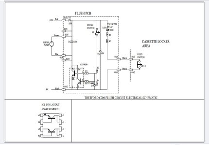

The pump is accessed from the flush panel , which is glued on . Use a thin piece of plastic to gently lift the panel , this will reveal the pump drive /switch pcb and another cover plate underneath . The pump is in the flush tank and connected to an anti siphon device and the output pipe which is pushed onto a small spigot and can be gently pulled out and the 12V/switch/ electronic/ pump can be checked to see which is at fault. Attached is a picture of the switch/pump drive pcb which is used across various models of thetford toilets which may help diagnose why the pump isn't working
