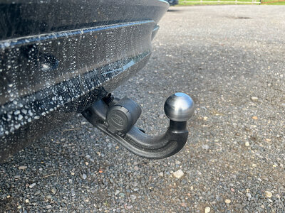

Mine stows upright and seems to be well protected from spray (as was the case on my previous Jag).
This is after two weeks but, from past experience of very similar installations, I'd expect it to look much the same after two months.
