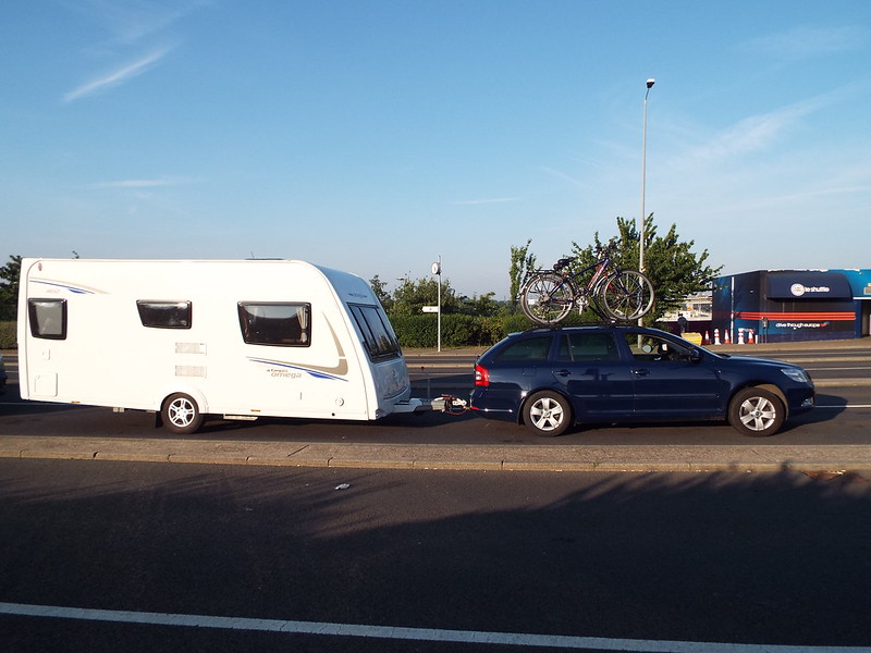

If you can find one, my 2012 Skoda Octavia Estate 2.0TDi 4x4 has a kerbweight of 1,495kg, GVW 2,095kg so with the van suggested, OK on a B licence. My van is 1,318kg (88% ratio) and pulls it no problem, lots of load space and of course extra traction when needed.
