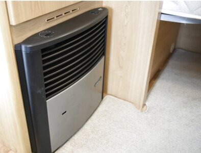

It's a 2004 swift fairway, the heater is the truma trumatic with the blown air system built in. I have attached a picture. The actual heating portion of the system works fine It's just the blown air that is supposed to be drawn over the heat through the front of the unit and then pass through vents in the caravan however the blown air is not working As mentioned in "op" I have a suspicion it could be the motor.

Thank you for the update. I can see now you have what looks like a Truma S3000 series convector heater, and the fact you mentioned a label in the electrical consumer unit marked "Fridge & Blown air" tells me the heater also has the Truma Ultraheat electric heating.
I also guess as you were not able to tell me the exact model, that you don't have the user manuals. You can find the manuals online either from the Truma website or other third party sites, and I encourage you to get them.
You actually have three Truma products, the S3000 series has convector heater, the Ultraheat electric elements, and a Trumavent blown air unit. They are designed to work together as their controls are integrated to some extent, but the blown air unit is a 12V dc fan system, and there should be a 12v fuse somewhere in the caravan relating to it.
As your caravan is about 20 years old now, it is possible the fan motor or PCB has failed.
