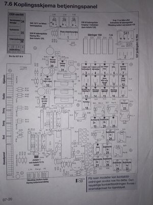

Hello i can offer some insight into the system from my own experience.
Just had the same issue on a 495 altho i dont know if yours is built the same, it might be.
The 24v underfloor heating has its transformer located under the sofa.
Its controlled from the main control box located in the cabinet.
The cable to the transformer is connected with an connector and switched with a small soldered 230v relay on the control box pcb. On mine the cable is labeled 35.
In my case tapping on the relay with a screwdriver released the stuck contacts and switched the floor heater off.
I will ofc need to replace the relay on the pcb later.
