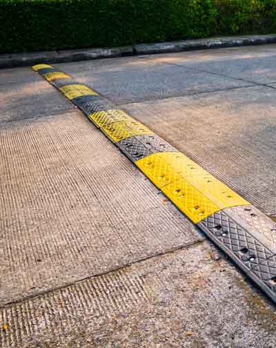

I found this information after my younger brother took out the front spoiler and aux drive belts on his Mercedes B class.
All roads are different, and you may need different speed bump lengths depending on the carriageway, but all speed bumps must be a minimum of 900mm in length according to The Highways (Road Humps) Regulations 1999. The height of speed humps must also be a minimum of 25mm but no more than 100mm at the highest point.8 Nov 2018
