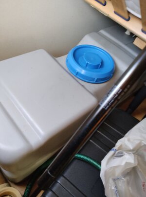

Hi any idea how to get water from my aquaroll into my caravan water tank under the bed
My old caravan had a water pump you submerged into the aqua to pump water in via a socket in the side of the van

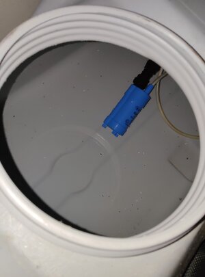

The van I have now has a bigish water tank under the bed with a water. Pump in there to supply the water to the taps
What I want to know is a way if possible to fill the tank from the aquaroll
Other than using a funnel and lifting the aqua roll up to fill

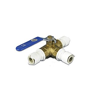

Use a 2 way valve with one going to your taps and the other to the tank. If the pump relies on pressure, once the tap is positioned towards the tank it will fill. Don't forget to swap the valve back once you have done!

Without more information it is difficult to be sure, but is this just an inboard pump and simply needs a pipe from the inlet into the Aquaroll. Can you not go back to the seller to ask if you are stuck?
