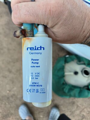

I assume you mean an internal pump. I fitted a Flojet positive displacement pump.

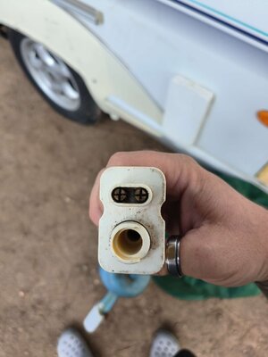

What make/type water connection point is fitted to the caravan??External pumps are quieter than internal. A picture would help if you aren’t certain of the fitment type.
Here’s a photo of a typical type.
You can replace the whole lot for about 60.00 (search Whale/Truma pump and ensure the caravan fitting matches) or you can buy just the pump with a long cable between 10.00 and 20.00 to fit yourself - assuming you can dismantle the caravan end. I think the Reich was a replacement from the original as it shows 10lpm (litre per minute) and I think the original was 14lpm. Certainly EBay advertise several sellers with Whale or Comet pumps that run at the same 6 Bar pressure.
If the pump is jammed might be worth seeing if you can reach the impeller with a fine screwdriver through the bottom and see if it is free to spin.
The fitting you have in your caravan is a Carver Crystal mk1 design. Some sellers may still have parts for these. But the pump can be any 12V dc submersible pump, it doesn't have to be a specific make.
The most common reason for the failure of sub pumps, is either running out of water in the barrel, and the pump continues to run dry. The heat build up in the pump damages the plastic seals which eventually fail and floods the motor.

(Edit) PS. The Reich pump in your picture is not the original, a previous owner must have already replaced at least once
