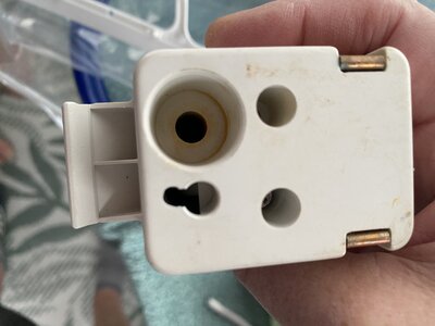

Looking for some advice my whale water master pump was playing up so I tried ever everything with the terminals all clean everything was good I put the new one on everything work in but after closer inspection I found they one of the screws holding the two parts that connect to the caravan was missing must of worked loose some how hadn’t noticed now I’m looking for a screw to fit the pump insert

Take the other one out and use it as a guide to what you need. I'm sure your local diy store will have something.
While both screws are out separate the two parts and check the part that the screw goes into. You may find that it has split, which would explain why the original screw worked loose and fell out.
