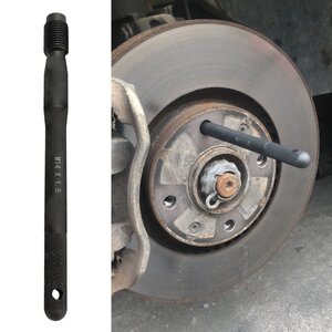

In anticipation of our first trip I’m in the process of putting together a tool kit to be kept in the caravan. Being a restorer of cars my first list covered tools that would have been fit to build a caravan from scratch! So I'm in the process of whittling the list down to something more practical (and lighter) !
One tool that will remain on the list may be unfamiliar to some of you is a “wheel alignment pin” Now if you have ever changed a wheel that has bolts rather than nuts (most Alko axles seem to have bolts) you will appreciate that it can be tricky to hold the wheel in the right place, whilst supporting its weight and trying to get at least one stud in, you really need 3 hands and be at eye level with the wheel.
A wheel alignment pin is simply a long stud that screws in to the hub, meaning that you can quickly and with a lot less effort get the wheel fitted, hanging on the pin, whilst you put the other wheel bolts back, they only cost a couple of quid, a godsend when changing a wheel on you own.

Yep, got two of those alignment pins now. It's worse with the Alko hubs as the wheel doesn't even centre on the middle of the hub like it does on some cars.
Agree, at least on a car the wheel can be centred and supported on the hub.
The pic I used in the original post is not a caravan with disc brakes! I lifted it from the web to illustrate the pin, rather than take a wheel off our van!

VW Touaregs get a wheel alignment pin in the tool kit - it does help to get the wheels fitted although my tyre fitter who does the regular rotation for me does just fine without - I must check to see if the thread will fit the caravan hub.
Thanks for posting this. I recently replaced the front brake pads on my KIA Sorento which has 19" alloy wheels. The worst part of the job was trying to refit the wheels while kneeling on the ground because they are so incredibly heavy.
Where did you buy yours from?
