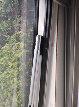

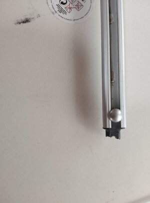

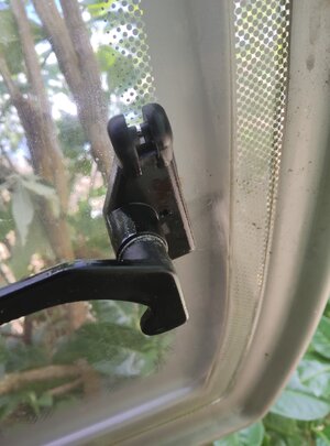

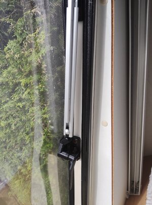

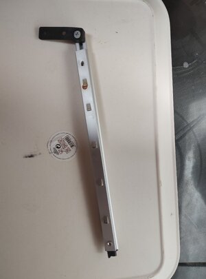

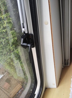

I am getting my van ready to go on the road and noticed a couple of issues with the window stays
One window a small side one has the clip broken and thus has been pot riveted on
Any ideas or do i have that buy a complete new one
Secondly but I bought the van second hand I knew it only had on one side at the front but I need to source a replacement
Are these standard or caravan specific there is no ref on these and my caravan company is no longer in business
Thanks

Measure the closed length ( 300mm is common, shorter ones for the kitchen window) and just search online note there are two common types , ones that have a knob to tighten them in place and the ones which click into place ( 3 positions) which looking at your stays they are the latter.The last ones I bought I got from Caravancrazy.co.uk
Thank you Ian
The slider type are made by polyplastic these have a triangular adjuster and Elba which have a circular adjuster, in my case I found them non interchangeable,James's with the indent button seem an improvement on those above,,one of my next "things to do" is replace some of the longer struts with shorter ones on the nearside windows to avoid my at present ability to walk into them when exiting my caravan 😆
