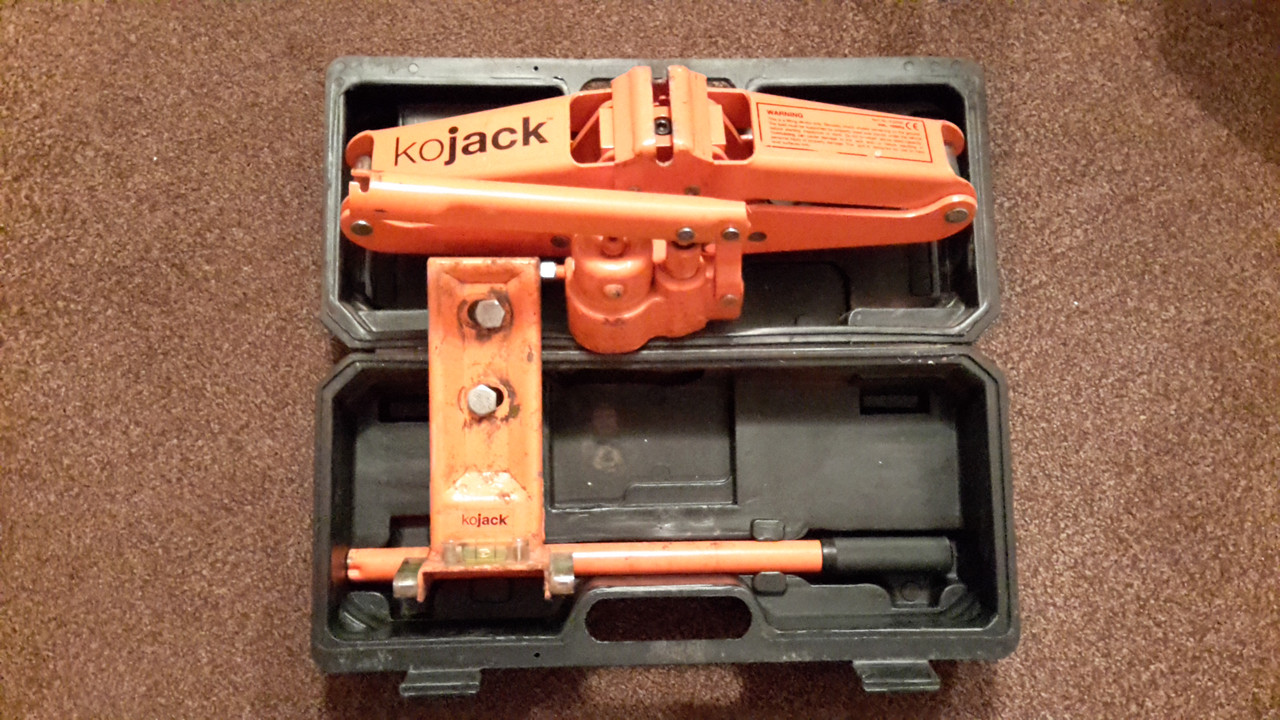

Pensioner, If I am correct you have bought a Kojack , jack, The orange Fittings have a bubble levelling on them.
Check your Chassis and see if it already has two grey, jacking points fitted. My 2013 Alko chassis had them fitted and they were suitable for the Kojack as opposed to the earlier Alko which would bend, I think Dusty Dog has some photos.

The jack I pictured is the larger one, for upto I think 2000kg the smaller bottle bottle jack without the Scissor effect is for upto 1000 kg, Willing to be corrected. .
My original jacking point are just behind the axle, and the brackets look a bit better than my old Kojack ones that I showed in the pictures.
Are these yours.

I have just realised in the Video the bloke is fitting the old style of ALKO jack point which can fold up when the caravan is being jacked up with a heavier van. The type you have bought should fit in the place where the bloke was fitting them though.
