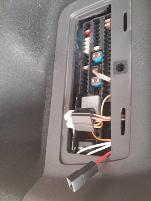

Pin 10 update. It has never been connected. See attached photo. The constant 12 volt has been taken from Brown and white stripe wire to left and red wire you can see unattached ends up at pin 10. Any advice where I could tap 12 volt fridge voltage from?
