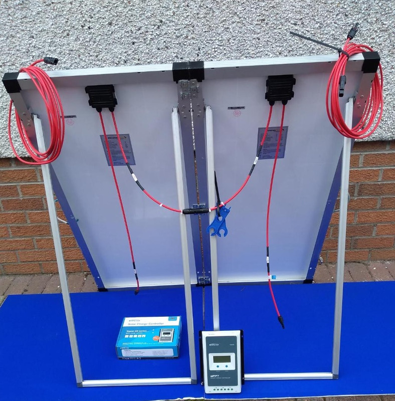

200 watt folding solar suitcase.
Finally decided on my solar panel system preference.
I bought 2 100w monochrystaline panels and made adjustable supports, fitted hinges and toggle latches etc.
Purchased cable and connectors etc. online and used some items I already had in the garage.
I went for a 200 watt folding suitcase with 32 amp MPPT controller, I abandoned the idea of using existing EHU cables and fitted dedicated recommended cabling at all points.
I enjoyed putting it all together and saved quite a bit of money in the process, the controller will be mounted inside the caravan, set up and pack away time should literally be a few minutes.
Raywood said:
Looks good. Perhaps the magazine would want to see it and show us all how to do it.
I would be interested in reading that. I've seen solar panels inside the caravan as a battery conditioner for storage, but how do you connect it to the battery? mine is sealed from the inside of the van.
