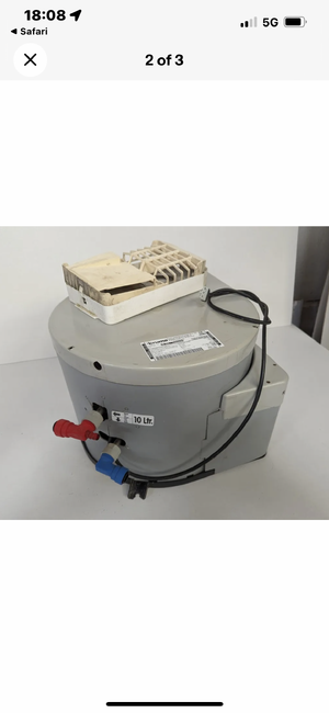

Hiya - thank you for taking the time to reply. Our caravan is a 2001 Swift Conqueror 580 SL. Very old but still in good nick.
The only tank under the benches is this Truma Ultrastore (stock pic below). We always thought this was the internal water system lol.
Unless the internal tank is under the caravan - there is definitely no other tank inside.

The Conqueror has never had an internal or onboard tank. The pictures shows the hot water boiler. Can we assume that the aquaroll is full of water and that the external pump into the aquaroll is working? You can hear it hum when the impeller is turning which happens when a tap is opened. To get the system working you need to prime it.
First make sure that the drain valve for the boiler is closed. This is generally a small flat yellow lever type switch near the boiler.. Make sure it is closed. Next open all the taps in the caravan making sure that the water is going to drain away. Then switch on the pump. After a few minutes you shoudl hear some gurgling. This is the hot water boiler filling up with water and cab take several minutes. Once it is full, water should start flowing from the taps.
