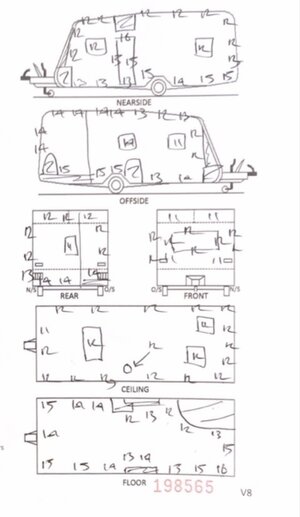

I enclose a photo of a damp survey undertaken on my last caravan. The readings shown were quite a bit higher than normal but my AWS technician who knew the caravan and models like it wasn't fussed. The reason being we had only just returned from an incredibly wet two weeks on he North York Moors. We had two dogs in with us and to add insult to injury the site owners decided not to have the showers open citing covid. So we had to use our own shower. They gave a ÂŁ2 day refund saying that we were still using their electric and water. A true embodiment of the Yorkshire spirit of frugality đŸ˜± And then on “Freedom Day” 17th May the village pub decided to stay shut.
Anyway by late June the levels had come down by 3-4%. The buyer of the caravan was experienced and brought his own meter along and just spot checked a few points to confirm the trend for reduced readings from my own meter.
Hopefully seeing the AWS survey along with Dusty’s advice gives you an idea of what to do and where to check.
