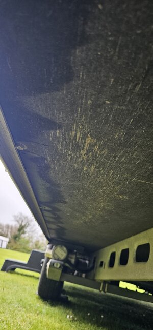

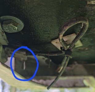

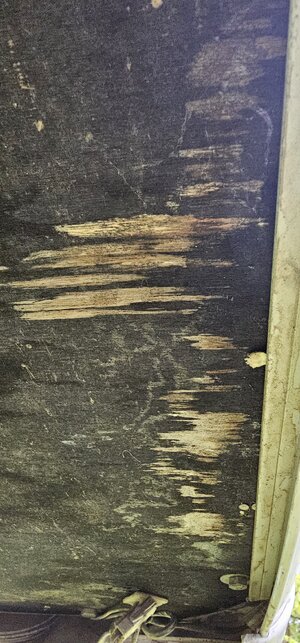

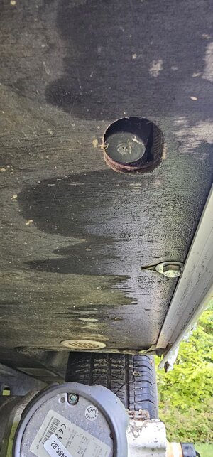

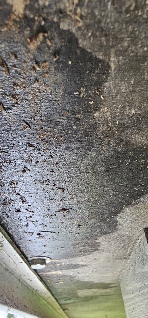

When I looked underneath after rain there is a constant dripping of water from this point in the corner ...I assume this is normal ? As you can see the floor is getting a soaking and I can feel soft spots in wood which is in line with the inspection

While looking for latest van I inspected two 2010 Ranger 460/4 that had water damped floors where yours are wet. Along both sides on rear, ie behind wheel to rear corners. Front half of both vans were fine. After that I stopped looking at these models.
In your case it could be rain water blown up and under in which case should be wet all along one side front to rear and would dry quickly. If only rear and not dry after a couple days I suspect its coming from inside.

Next is a report from the current dealer detailing the reasons why they think the damp may have occurred. Screws through the floor is a sign of poor workmanship. As they are not the supplier it is no skin off their nose giving you possible reasons.

It would appear the caravan has recently been towed, so the underside of the floor will inevitably show signs of spray from not only the caravan tyres but also the tow vehicle, consequently you cannot make a clear conclusion just from the pictures you have posted, however the preponderance of dampness along the majority of the caravans edges does suggest water is possibly emerging from the bottom of the walls.
