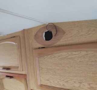

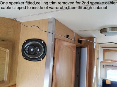

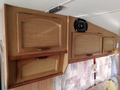

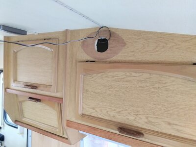

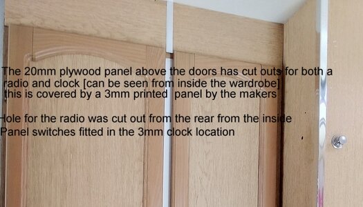

I recently fitted a car radio into my GTS,I found that provisions for both a radio and clock a available on the inside top panel of the wardrobe,(More than likely for the larger Spectrum model of which mine is a shortened version).I fitted a suitable shelf for the radio to rest on leaving a gap to allow any heat to disperse,also the radio is resting on a piece of foam mat 00_084331.jpg04_084350.jpg06_084407.jpg07_084430.jpg08_084453.jpg09_084513.jpg12_084543.jpg
